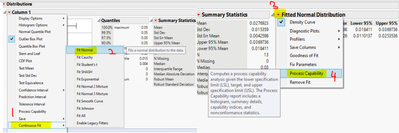

For JMP 17 to display Cpk, you need to fit the data to normal distribution.
So, you can click "Continuous fit" -> "fit normal" distribution " -> click the red triangle to perform capability analysis -> specify specs.

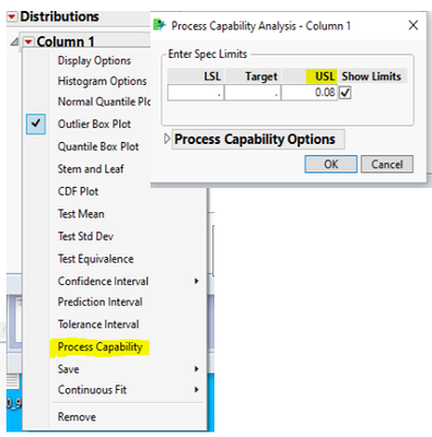

Alternatively, you can also force normal distribution by clicking "Process Capability" from the red triangle.
Define USL. JMP will show you the Cpk.
I think only normal distribution will display Cpk.
Cpk = min (Cpu, Cpl).
So, if you have only upper spec limit, Cpk = Cpu because Cpl not exist.
