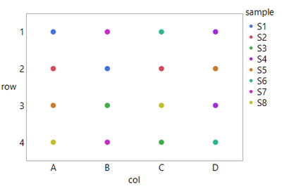

I would like to use JMP to create all of the possible plate layouts for a biological assay:
1. where the plate has 4 cols and 4 rows and 8 samples are duplicated on the plate (example illustrated below)
2. where the plate has 4 cols and 6 rows and 12 samples are duplicated on the plate
Is this possible using the JMP DoE platform?
one example layout for a 4x4 plate with 8 duplicated samples:

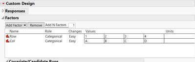

I think your main design could be generated very easily with the platform "Custom DoE" :
  1. Specify your 2 categorical factors "Col" and "Row" with 4 levels :
  2. Specify a model with main effects and the 2-factors interaction. You can choose the minimum number of runs (16) to have one experiment for each of the location points like in your graph, else the recommended default number 32 will provide 2 runs for each position.

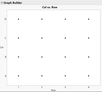

Example with the 16-runs DoE :
Here is the script to get to the minimum number of runs DOE :

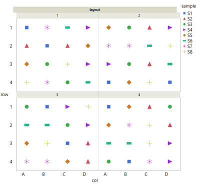

The duplication comes from the fact that each sample will appear on each plate two times. I've used different symbols in the graph below to try to make things more obvious. I'm trying to figure out how to generate a data table which contains all of the possible plate layouts (four unique plate layouts are illustrated below).

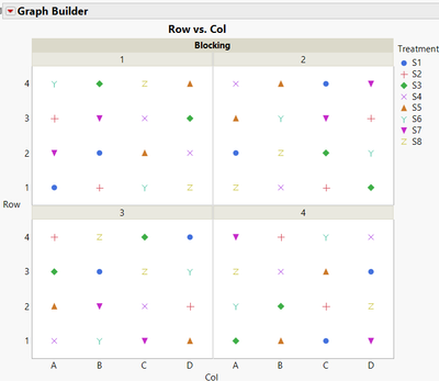

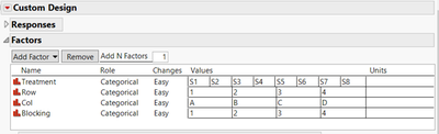

Sorry for my misunderstanding @Fiona_Baines, I think I better understand now your use case.
By using this setup for the DOE (and using only main effects in the model) :
And by specifying optimality criterion as Alias-Optimal, increasing design search time and number of random starts (to converge towards the design you want), I am able to have the design you expect :
Here is the script is you want to reproduce it :
DOE(
	Custom Design,
	{Add Response( Maximize, "Y", ., ., . ),
	Add Factor(
		Categorical,
		{"S1", "S2", "S3", "S4", "S5", "S6", "S7", "S8"},
		"Treatment",
		0
	), Add Factor( Categorical, {"1", "2", "3", "4"}, "Row", 0 ),
	Add Factor( Categorical, {"A", "B", "C", "D"}, "Col", 0 ),
	Add Factor( Categorical, {"1", "2", "3", "4"}, "Blocking", 0 ),
	Set Random Seed( 1635750691 ), Number of Starts( 77 ), Add Term( {1, 0} ),
	Add Term( {1, 1} ), Add Term( {2, 1} ), Add Term( {3, 1} ), Add Term( {4, 1} ),
	Add Alias Term( {1, 1}, {2, 1} ), Add Alias Term( {1, 1}, {3, 1} ),
	Add Alias Term( {1, 1}, {4, 1} ), Add Alias Term( {2, 1}, {3, 1} ),
	Add Alias Term( {2, 1}, {4, 1} ), Add Alias Term( {3, 1}, {4, 1} ),
	Set Sample Size( 64 ), Optimality Criterion( "Make Alias Optimal Design" ),
	Simulate Responses( 0 ), Save X Matrix( 0 ), Make Design,
	Set Run Order( Randomize within Blocks ), Make Table}
And attached the datatable with graph script.
There might be a more straightforward and easier way to do this design, but this option can still be helpful.
This design should better fit with your expectations :)
