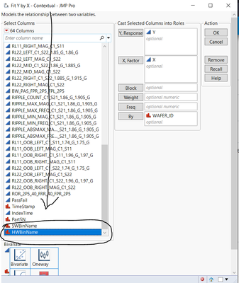

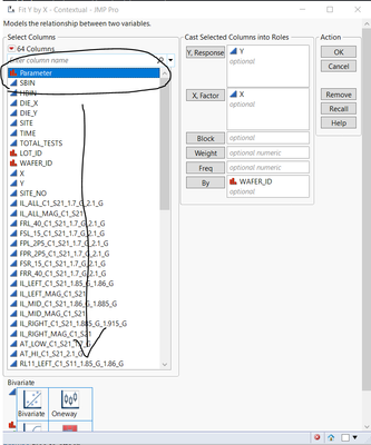

Hello community, i have a question. How do i create all the column option in my data table to make a choice for inside in Y,response? some of my data table is different name column and i want pick one of these column in Y,response.
Here example of my question
i want to make choice box option for column starting from Parameter to HWBinName and the selected column inside in Y,response.
note: for Parameter & HWBinName is same for all my data table
       : for the Y, X, WAFER_ID is static for all data table
I already upload my data table below, use it for reference thankyou.

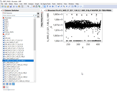

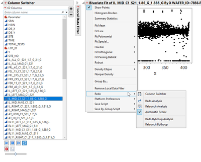

Is the column switcher an option to exchange the y column with the column you want to investigate?
Can you work Inside the values of the column  with local data filter?

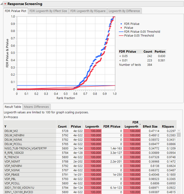

This may be slightly side-stepping your question, but have you looked into the Response Screening Platform (Analyze...Screening...Response Screening)? This platform fits large numbers of Y by X combinations quickly, with output that might end up saving you time.
Link to JMP help/example
