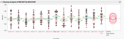

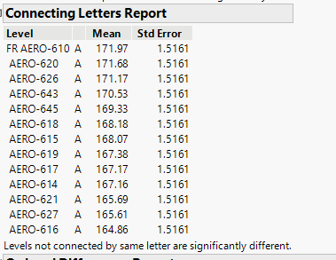

How to correct the data comparison.
I have a P Value of less than 0.05 but the connecting letters are all "A"
1 REPLY 1
MRB3855
Re: How to correct the data comparison.
Hi @PivotalParrot79 : This phenomena is not unusual. See link below for an explanation.
https://www.researchgate.net/post/Has-anyone-ever-had-an-ANOVA-with-P00001-and-with-no-difference-be...
