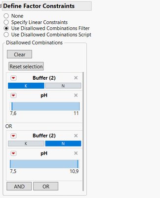

I am trying to generate a design with 6 factors in JMP, each of which has two levels. I am using two different buffers, and I want to use a separate buffer for each pH. When I use the 'disallowed combinations filter', and I constrain each pH to a specific buffer, I get an alert of  'optimal designer failed to converge'.
Here are the factors that I am using. Any help is appreciated!

PS: The snapshot you give does not correspond to the situation you described, as you need to specify what are the combinations NOT to be included in the design. In your case, you'll have something like :
Note that I don't generally put the limit exactly on the threshold values (7,5 and 11 in this example) in order for the exchange coordinate alogrithm in the Custom Design to be able to converge (but here this is not the only problem, as factors buffer and pH are completely confounded).
