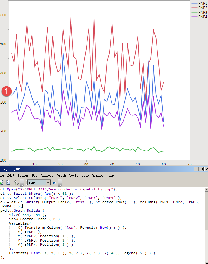

For example, using THE JMP example, we get 4 curves. How do we compare their similarity?
With "PNP1" as the standard, the other three groups of curves are compared with it and the one most similar to "PNP1" is obtained.

dt=Open("$SAMPLE_DATA/Semiconductor Capability.jmp");
dt << Select Where( Row() < 61 );
dt << Select Columns( "PNP1", "PNP2", "PNP3", "PNP4" );
d3 = dt << Subset( Output Table( "test" ), Selected Rows( 1 ), columns( PNP1, PNP2,  PNP3, PNP4 ) );
p=d3<<Graph Builder(
	Size( 534, 454 ),
	Show Control Panel( 0 ),
	Variables(
		X( Transform Column( "Row", Formula( Row() ) ) ),
		Y( :PNP1 ),
		Y( :PNP2, Position( 1 ) ),
		Y( :PNP3, Position( 1 ) ),
		Y( :PNP4, Position( 1 ) )
	Elements( Line( X, Y( 1 ), Y( 2 ), Y( 3 ), Y( 4 ), Legend( 5 ) ) )

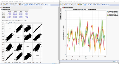

In case of your example, you may want to look at correlations, it shows that it is highest between PNP1 and PNP4.
And the Standardized curves are almost identical. You can sum up the squares of point differences along all rows to find the best fitting combination. But as SamGardner pointed out already, the solution depends on your data, there is no one way for all problems.
