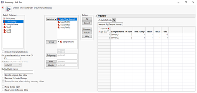

Maybe Summary table is enough for you?
You might have to do additional join to get the extra columns

Oh I'll try this! If it works that would be perfect and so much easier than the convoluted process I was trying.
