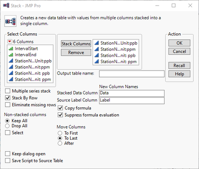

No doubt there are many ways to do this, here is the first that came to mind assuming the column format in your example is consistent. You can either run the script at the bottom of the post to see a full example or follow along with the green comments in the script and the screenshots below:
Bring all station data into a single column using Stack:

//Stack all of the columns - use Tables > Stack and include all of the columns except the first two which are times
dtStacked = dt << Stack(
	columns(
		(dt << Get Column Names())[3::n col(dt)]
	Source Label Column( "Label" ),
	Stacked Data Column( "Data" )

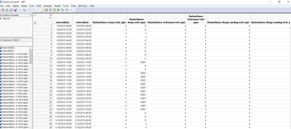

Ese_Omatsone
Level I
Re: How to combine data measured in different units
Hi Jim,
I posted a picture of that the data looks like, in answer to your question.  Please tell me the steps to change the data in place.
Thank you.
dale_lehman
Level VII
Does the data appear as numeric (without the units - or units in a separate field) or as character data where the units appear with the number (e.g., 13ppm)?  It would be easier if you can provide an example of how the data appears.  A formula should make the conversion you want, but exactly what formula depends on what the data looks like.
Ese_Omatsone
Level I
Ese_Omatsone
Level I
Hi,
This is what the data looks like.  The column name says the station and the units for the measurement.
Thank you kindly for the help.
