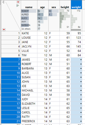

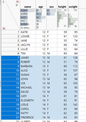

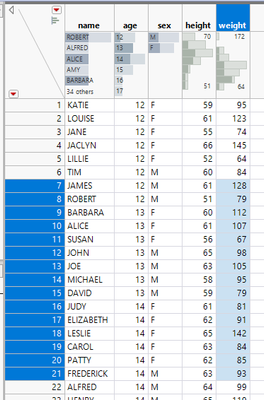

When you have your rows selected which you want to clear
while holding ALT press on the column name you want to remove the values from
you should end up values selected only from that column. Then you can press delete to remove the values (or set them as missing)
