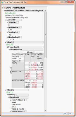

If you are unlucky enough to not have a copy of TCWoJWT, there are many references online that detail the calculation of HSD itself, for instance the NIST/SEMATECH Engineering Statistics Handbook has a section here.  If you want to grab the HSD results from a report, generate the report and right-click on the graph and choose Edit -> Show Tree Structure and note the object that holds the results you desire.  For a model of the TYPING DATA sample dataset, for instance, the picture below shows that the HSD confidence interval values are reported in CrosstabBox(1), nested in several other display type boxes:
The Scripting Guide has a number of examples on how to extract information from reports once you locate the specific information in the report's Tree Structure.  SAS Press has some books on JSL that may prove helpful too.
