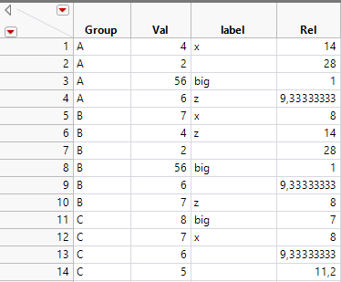

Vvvv
Level II
Re: How to calculate relativ values based on a position of a base value?
Hi Brady,
hopefully this is allowed even though the original question has already been answered.
I have a similar problem as lukasz, and I've been trying to tweak your (very good) answer to fit my problem.
Basically I am also trying to divide one column by itself, however I am not using the 2nd (or kth) as reference but instead I have a third column named label which I want to use to find the reference points. The problem I have is that I can't figure out how to get the "by-loop" working in my case, all my script does now is it divides every value by the first value named "big" (I understand why, but not how to fix it).
c << new column("Rel", numeric, continuous, formula(
	Eval(
	Eval Expr(
		:Val[(:Group << get data table) << get rows where(
			label == "big" & :Group == Expr( :Group[Row()] )
		)] / :Val
/ V
