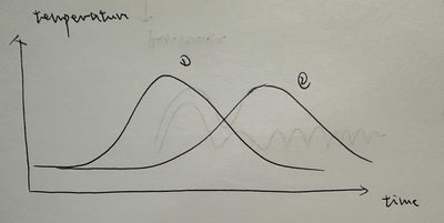

Hi Mike,
Thanks! Here is an example:
We may differentiate the two curves from the peak.
Is there any way we could differentiate the two directly? Can we calculate the peak area? or locate the peak?
There are a lot of curves in our case and some of them may be overlapped or not, or have the same peak values.
Thank you!
