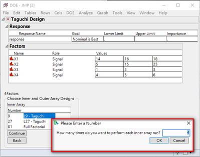

I want to do Taguchi L9/L18 iteratively based on different factor value & response goal.
And I've created simple jmp script but no idea about controlling inner array pop up window.
Is there any solution to automate the Taguchi process using JSL?

report(d)[button box(1) ]<< Click;
//Inner array run(key in inner array number & click OK) <----how to do this
//Click Make Table

Hi @Iris_ ,
  I don't think you are able to bypass the modal popup window that JMP displays after the first DOE Taguchi window. Since the modal popup window is from within JMP (not JSL), you can't bypass it, not even by mimicking a mouse click or mimicking pressing the return key. I think you have to manually hit enter. I believe that since JMP is calling a modal popup window after you "click" "OK" with the JSL you wrote, the JSL code is "frozen" until the user interacts with the modal popup window. So, trying to script something in order to fully automate the Taguchi array isn't likely to work.
