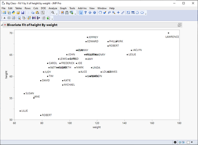

Hello,
          this seemingly easy task has been frustrating.
I have a column of labels in addition to my X/Y data points. I want to add a label to each of the data points using the labels column in the 'Fit Y by X' platform, NOT IN GRAPH BUILDER. (The reason is that I want a line fit with the slope forced at 1).
I searched but could not find a solution. JMP 18.
Any ideas?

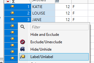

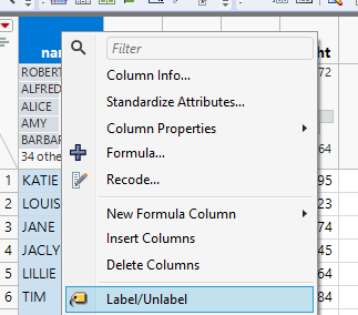

Using label column properties + label row state is one option:
Enable labels on your column(s) you wish to label
Select rows you wish to label and then label them

jthi
Re: How to add labels to data points in Fit Y by X platform?
Ah yes, missed that. Thanks.
