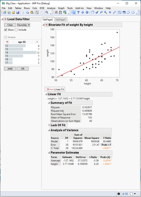

Because you are asking about option 2, I think you might want a local data filter to apply to multiple reports or platforms on multiple tabs. To do this,
  1. Use create a new JMP Application and pick a start with a blank application. Please see: https://www.jmp.com/support/help/en/16.0/index.shtml#page/jmp/additional-examples-of-creating-applic... for more information on creating JMP Applications.
  2. Double-click Data Filter Context Box. This adds a data filter context box to the workspace. Everything placed in this box will share the same Local Data Filter.
  3. Under Containers, drag a H List Box into the Data Filter Context Box. This allows you to put multiple objects in this box and arrange them horizontally.
  4. Drag a Data Filter (local) into the H List Box.
  5. Under Containers, drag a Tab Box into the H List Box.
  6. Then, add reports or platforms to the Tab Box.
  7. Run the Application to choose settings for the local data filter.

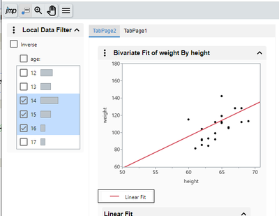

It should look something like this:
Notice that I disabled the Include mode of the local data filter.
You should be able to export to Interactive HTML and it would look something like this:
I hope that helps.
