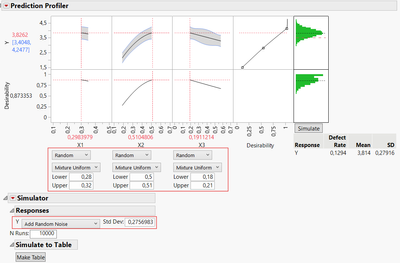

    Here is an example on Piepel dataset from JMP, where I added random mixture uniform variation on the mixture factors and a random noise on the measured Y response to simulate the overall variability in this optimal area :
    Provided you have a model linking your Y measured response for each method and your particle size, you can specify a particle size distribution and add a random noise on your measured response to create a table where you can further visualize and analyze the difference between the methods.
