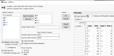

If you have data like this
Stack it

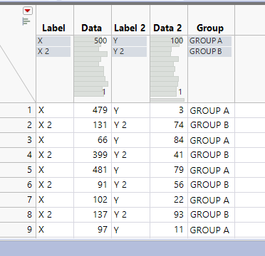

Then create grouping column (depends on how you have named your columns), remove label columns and rename data columns

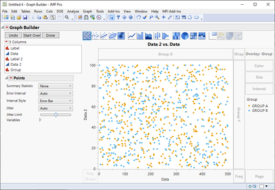

and then you should be able to plot them
You can also place group on Wrap, Group X/Y or Page depending on your data and what you are trying to plot

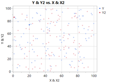

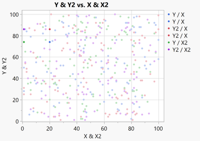

Then you can just plot the points twice - with twice all your X values AND all your Y values. Then the plot will look really crowded, because you will get point for every combination of X and Y:

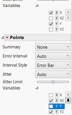

No, open the settings menu of each points plots and just select one combination:
Then you will get a plot like this:
