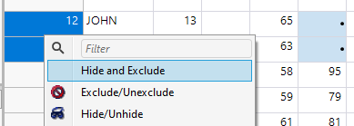

How does your data look like? Can you exclude the whole row? If you can, select one of the missing values, right click on it, select matching cells and then right click on the row number and hide and exclude

Thank you for your response. I knew the exclude option. I was looking for something where I can specifically exclude the random missing cells without having to apply imputation before my analysis.
