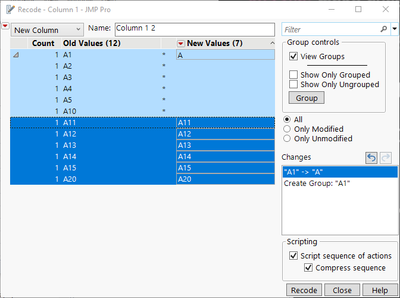

Is there a way to do it by chunks/groups in the recode platform though? Doing it by hand for 100+ samples and multiple datasets would take quite a bit of time.

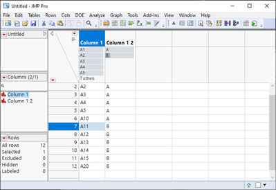

Have you tried it? Recode platform will provide you with a script, such as
ocal({dt, col1},
	dt = Data Table("Untitled");
	dt << Begin Data Update;
	col1 = dt << New Column(dt:Column 1);
	col1 << Set Name("Column 1 2");
	dt << Move Selected Columns({col1}, after(dt:Column 1));
	For Each Row(
		dt,
		col1[] = Map Value(
			dt:Column 1,
			{"A10", "A1", "A2", "A1", "A3", "A1"},
			Unmatched(dt:Column 1)
	dt << End Data Update;
You can then modify that as needed and maybe use something like Workflow builder to make it work with different tables. Or you can script it (Get Data Table List() and For Each are good starting points for this).
