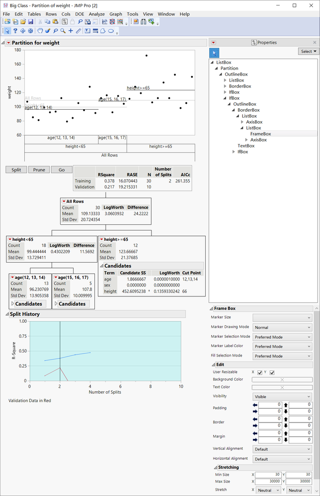

How many splits are performed automatically by the decision tree model using JSL?
For example, the number of splits in the figure is 3
How to script this split number 3 to a variable?

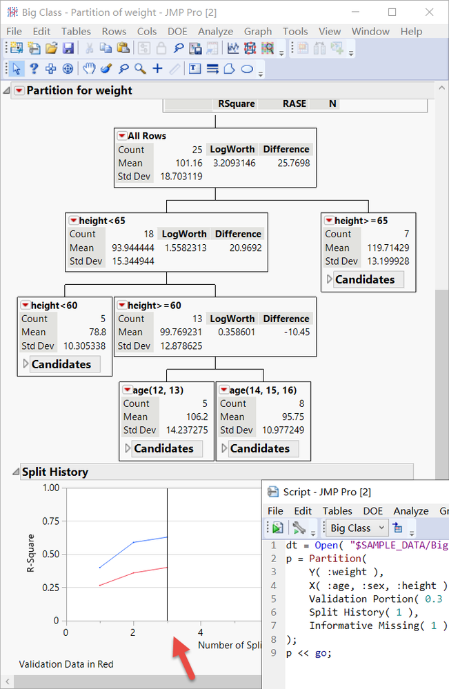

p = Partition(
	Y( :weight ),
	X( :age, :sex, :height ),
	Validation Portion( 0.3 ),
	Split History( 1 ),
	Informative Missing( 1 )
p << go;
splitCount = p << GetProperty( "Tree Split Count" );//??
Thanks!

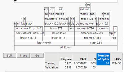

You can get the count from the table box
Names Default To Here(1);
dt = Open("$SAMPLE_DATA/Boston Housing.jmp");
partition = dt << Partition(
	Y(:mvalue),
	X(
		:crim, :zn, :indus, :chas, :nox, :rooms, :age, :distance, :radial, :tax,
		:pt, :b, :lstat
	Validation Portion(0.3)
partition << go;
splitcount = (Report(partition)[Table Box(1), Number Col Box("Number of Splits")] << get)[1];
