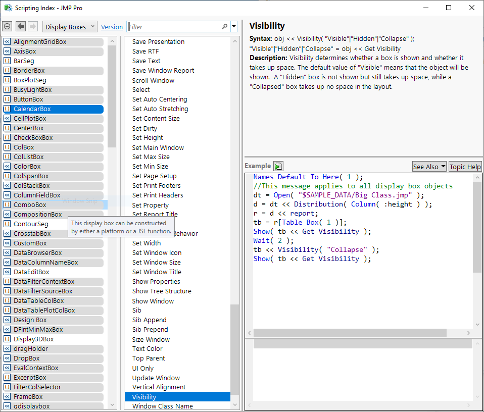

I usually recommend against deleting display boxes. Instead, you can control the visibility. Use the selected message as shown in this picture. I do not know how it will affect the behavior of the window if you hide or collapse the OK button. You must provide a way to dismiss the modal window.
