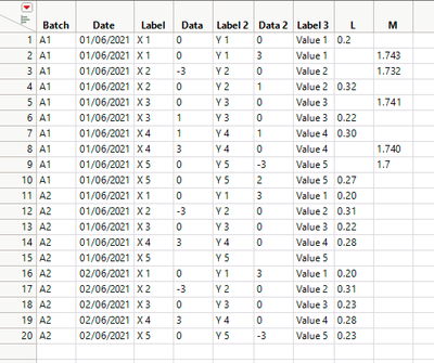

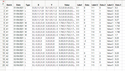

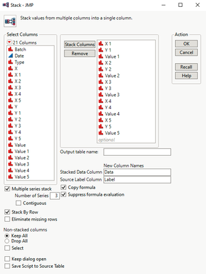

Hi txnelson, Thanks for taking the time to answer this.
Unfortunatley the output you get isn't what I'm looking for, but your use of the multiple series stack did start me off in the right direction.
I realised that I need to change the order of the columns in the multiple series stack and then do a split on the data3 column.
gives
then split on data 3
gives required output:

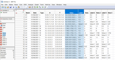

txnelson
Re: How do I transpose multiple delimited columns
Your request is an easily solvable task
To turn the concatenated data into separate columns,
     Select the 3 Columns
     Go to
          Cols=>Utilities=>Text to Columns
           Enter the "|" as the delimiter column
           Click on OK

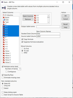

To transpose the columns go to (this is actually a stacking of the columns)
     Tables=>Stack
     Set up the dialog box like below
Click OK and you will get
gives
