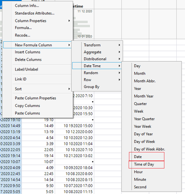

Solution built on the formulas "pre-made" by JMP when you right click on column name on date column for Date and Time Of Day:
