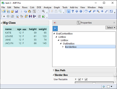

How do I retrieve a row of data from a table in a display window that has been selected?
I have a window that has a table in it (i.e., the first 5 rows of Big Class.jmp) that I created using the script below and I'd like to know:
1) that a row of the table was selected
2) retrieve the row of data from the table in the window
After the window has been made, let's assume the user selects a row of the table as shown in the attached image.
Note: I am using JMP ver 17.1.
names default to here(1);
dt = open("$sample_data\big class.jmp", invisible);
rpt = dt << select where(row()<5) << get as report;
nw = new window("test",
	v list box(
		outline box("Big Class", rpt)

Re: How do I retrieve a row of data from a table in a display window that has been selected?
Report from data table is Border box with Table box inside it so you can use that
Names Default To Here(1);
dt = Open("$sample_data\big class.jmp", invisible);
rpt = dt << select where(Row() < 5) << get as report;
nw = New Window("test",
	V List Box(
		Outline Box("Big Class",
			rpt
rpt[Table Box(1)] << Get Selected Rows;
after you know the object type you can fairly easily see from scripting index what you can do
or you could use Show Properties
Show Properties(rpt[Table Box(1)])
-Jarmo
