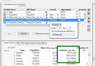

PMroz has the answer, but I might add that if you have JMP 12 and you use Query Builder to make your SQL queries, you can interactively format columns returned from a query:
You can also set modeling type for returned columns.  One of the benefits of Query Builder, even if you are comfortable writing your own SQL, is that it has interactive ways to do some of these things so that you might otherwise have to write scripts to do.
