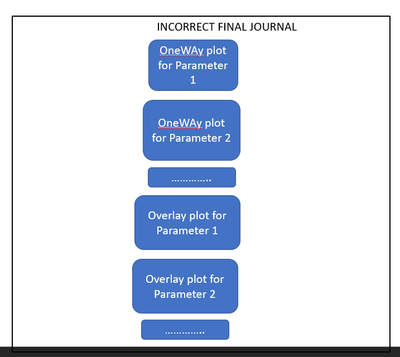

The above code makes equal number of overlay and oneway plots from my data. There are 84 unique "Parameter Names" so I get 84 overlay plots and 84 Oneway plots.
I am trying to combine them into a journal so that for each parameter I get the oneway plot right next to the overlay plot...and then subsequent plots vertically.
How can I do that?
This is the output I need
This is the output I am getting

Here is a rework of your script that I believe will give you a good start on your script
Names Default To Here( 1 );
dt = Open( "$sample_data/big class.jmp" );
overlayplot = dt << Overlay Plot(invisible,
	X( :height ),
	Y( :Name( "weight" ) ),
	Grouping( :sex ),
	SendToByGroup(
		{:age == Eval( :age )},
		Overlay Groups,
		Connect Thru Missing( 1 ),
		Connect Points( 1 ),
		:Name( "weight" )(Overlay Marker( 8 ), Line Width( "Thick" ))
	By( :age )
////////////////////////////////////////Makes 'N' Oneway plots. One each for each "Parameter Name"////////////////////////////////////////////////////////
ttest_plot = dt << Oneway(invisible,
	Y( :weight ),
	X( :sex ),
	Normal Quantile Label( 0 ),
	Box Plots( 1 ),
	X Axis Proportional( 0 ),
	Points Jittered( 1 ),
	by( :age ),
	SendToReport(
		Dispatch(
			"Oneway Plot",
			FrameBox,
			{DispatchSeg(
				Box Plot Seg( 1 ),
				{Confidence Diamond( 0 ), Line Color( "Red" )}
			), DispatchSeg(
				Box Plot Seg( 2 ),
// Create the output window
nw = new window("The Output", lub = lineup Box( NCol(2)));
// Find the numeber of by groupws
summarize(dt, bygroups = by(:age));
numByGroups = nitems(bygroups);
For(i=1,i<=numByGroups,i++,
	lub<<append(report(ttest_plot[i])[outlinebox(1)]);
	lub<<append(report(overlayplot[i])[outlinebox(1)]);
Note: I manually reduced the size of the overlay plots, you will need to add the JSL to set the frame size properly.
Jim

You can try using H List Box to set them side by side, but will most likely run into some issues with the sizing of different reports and have to handle that somehow. Below is an example with two different options which might give an idea how to do this (I haven't really used journals, so that part of the example might be a bit bad):
Names Default To Here(1);
/*with by*/
graph1 = Expr(dt << Oneway(Y(:height), X(:age), By(:sex)));
graph2 = Expr(dt << Graph Builder(
	Show Control Panel(0),
	Show Legend(0),
	Variables(X(Transform Column("Row", Formula(Row()))), Y(:height), Group Y(:age)),
	Elements(Points(X, Y, Legend(1))),
	By(:sex)
nw = new window("",
	h list box(
		vlistbox(graph1),
		vlistbox(graph2)
nw << journal window;
nw << close window;
stop();
/* without by*/
graph1 = Expr(dtTemp << Oneway(Y(:height), X(:age)));
graph2 = Expr(dtTemp << Graph Builder(
	Show Legend(0),
nw = new window("",
	vlb = v list box();
nw << Journal Window;
nw << close window;
byVals = Associative Array(dt:sex) << get keys;
For(i = 1, i <= N Items(byVals), i++,
	dt << Select Where(:sex == byVals[i]);
	dtTemp = dt << Subset(Selected Rows, all columns);
	hlb = V List Box(
		TextBox(byVals[i]),
		Lineup box(N Col(2),
			graph1,
			graph2
	hlb << Journal;
	Close(dtTemp, no save);

Thank you. Worked perfectly. Just needed to set the frame size.
