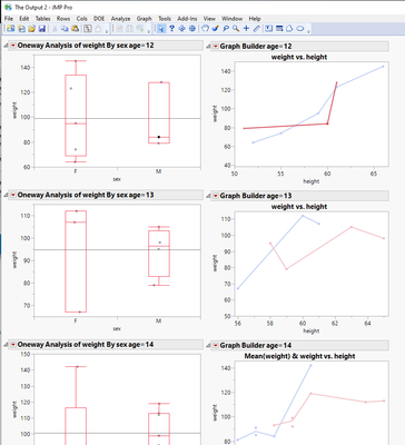

txnelson
Re: How do I merge two different types of graphs horizontally into a journal?
Here is a rework of your script that I believe will give you a good start on your script
Names Default To Here( 1 );
dt = Open( "$sample_data/big class.jmp" );
overlayplot = dt << Overlay Plot(invisible,
	X( :height ),
	Y( :Name( "weight" ) ),
	Grouping( :sex ),
	SendToByGroup(
		{:age == Eval( :age )},
		Overlay Groups,
		Connect Thru Missing( 1 ),
		Connect Points( 1 ),
		:Name( "weight" )(Overlay Marker( 8 ), Line Width( "Thick" ))
	By( :age )
////////////////////////////////////////Makes 'N' Oneway plots. One each for each "Parameter Name"////////////////////////////////////////////////////////
ttest_plot = dt << Oneway(invisible,
	Y( :weight ),
	X( :sex ),
	Normal Quantile Label( 0 ),
	Box Plots( 1 ),
	X Axis Proportional( 0 ),
	Points Jittered( 1 ),
	by( :age ),
	SendToReport(
		Dispatch(
			"Oneway Plot",
			FrameBox,
			{DispatchSeg(
				Box Plot Seg( 1 ),
				{Confidence Diamond( 0 ), Line Color( "Red" )}
			), DispatchSeg(
				Box Plot Seg( 2 ),
// Create the output window
nw = new window("The Output", lub = lineup Box( NCol(2)));
// Find the numeber of by groupws
summarize(dt, bygroups = by(:age));
numByGroups = nitems(bygroups);
For(i=1,i<=numByGroups,i++,
	lub<<append(report(ttest_plot[i])[outlinebox(1)]);
	lub<<append(report(overlayplot[i])[outlinebox(1)]);
Note: I manually reduced the size of the overlay plots, you will need to add the JSL to set the frame size properly.
