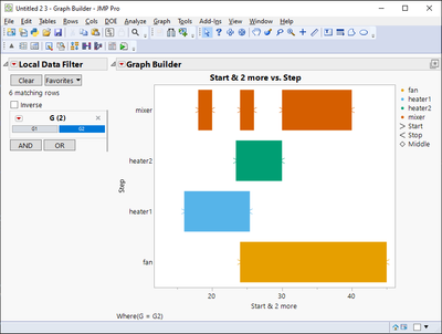

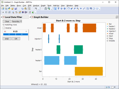

For now I would go with the marker draw expression and possibly add extra points within the "rectangle". Handling the color is a bit annoying as I don't think you can access color within set marker expr function, but you can manage for example with row states, adding color column to your table or picking the color from the marker. There could be some issues with local data filters, so I would probably avoid picking them from marker -> use color column or row states.
I think marker draw expression should be handle the local data filter fine. I haven't tested how well this works when you have large amount of data but there are most likely optimizations which could be done if that becomes an issue. You can also increase the height of bars to 0.4 (or values very close to 0.5) and they shouldn't overlap. In this case I replace middle marker with the rectangle and directly pick the color from row state

frame = Report(gb)[FrameBox(1)];
seg = (frame << FindSeg(Marker Seg(3)));
seg << Set Marker Draw Expr(
	Function({this seg, this row, x, y, size, row state},
		Fill Color(Color Of(row state));
		Rect(:Start[this row], y + 0.4, :Stop[this row], y - 0.4, 1)
Also it is also fairly easy easy to crash JMP when you start playing around with these.

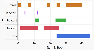

JMP19 is available now, which makes it super easy to create plots like this:
dt = New Table( "log",
	Add Rows( 12 ),
	New Column( "Step",
		Character,
		Set Values(
			{"mixer", "heater1", "injector1", "mixer", "heater2", "injector1",
			"heater1", "mixer", "heater2", "mixer", "fan", "mixer"}
	New Column( "Start",
		Set Values(
			[0, 1, 4, 6, 10.3, 12, 16, 18, 23.4, 24, 24,30]
	New Column( "Stop",
		Set Values(
			[2, 12.3, 4.5, 8, 13, 12.5, 25.4, 20, 30, 26,45, 40]
Graph Builder(
	Size( 493, 262 ),
	Graph Spacing( 4 ),
	Variables( X( :Start ), X( :Stop, Position( 1 ) ), Y( :Step ), Color( :Step ) ),
	Elements( Line( X( 1 ), X( 2 ), Y,  Ordering( "Within Row" ) ) ),
