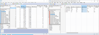

I splited one data table to two data table.
one has value of test items(*Data type : Numeric & Continuous) , another one has upper limit & lower limit.(*Charactor & Norminal)
Column names(=test item names) are the same in 2 different data table.
Two sample data tables are like right below.

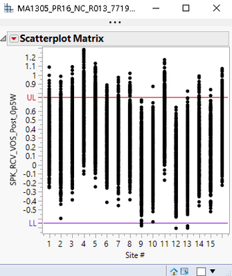

With these two, I wanna have a Scatterplot Matrix report like below.
I have some questions.

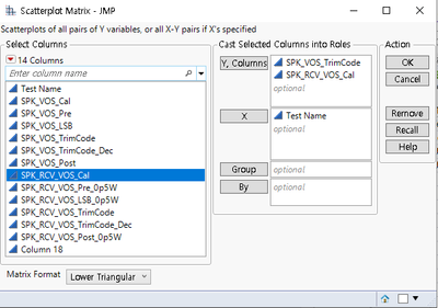

1.Fixed X Axis(Column#1 Named "Test Name"). but Y Axis will be selected with something like dialog for users. (*Multiple Items)
  Since X is fixed, I want to select only Y Items. filter is necessary for finding test items.
2.I want to add referrence line to each Scatterplot Matrix. (*Two referrence line : Upper limit, Low limit.)
3.I want to show only report. not data table.
