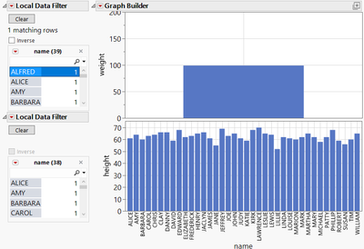

I have a window containing two graph builders, pulling from two different datasets, and I want to filter both graphs with a single Data Filter. I don't think this is possible. I've thought about instead using two "synced" data filters, but couldn't figure it out. Last week at JMP Discovery, @danschikore pointed me toward event handlers as a possible solution for using two synced filters. I think I'm close to getting it to work, but I'm stuck.
The script below creates the two filters and two graphs. I want the selections made in the top filter to be automatically reflected in the bottom filter. Once that works, I will hide the bottom filter and the user will see one filter controlling both graphs.
As it is now, when the user makes a selection in the top filter, the script prints that Where clause to the log using "Get Where Clause", but I need to apply this where clause to the bottom filter. I want a command like "Set Where Clause" that would let me shove that where clause text into the bottom filter, but it doesn't seem to exist.  I'm really hoping to avoid the scenario where I have to "unpack" the text string (below) and turn it into a form I can pass to the lower filter.
Select Where( :name == \!"ALICE\!" | :name == \!"BARBARA\!" )
Just to convince myself I can get the first filter to control the second one in some fashion, I have the first filter clearing the second filter's selection. That means I can talk to both filters; I can extract the where clause from the first; I just can't apply it to the second.
As a bonus question: Once this syncing works. I want to hide the second filter.  The last line of the script hides the first filter. Does anyone know how I could modify this to hide the second filter instead?

Re: How do I make one Data Filter mirror another?
Make sure that both tables contain the same values!
If the data filter doesn't find a matching row, it will reset and show all rows:
This issue will be fixed in JMP19 via :folded_hands: Column Property: Inclusive/forced Values
As a workaround for <=JMP18, you can add dummy rows with missing data in the remaining columns
-> won't show up in the plot but will prevent the data filter from getting reset.

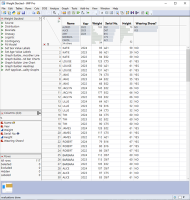

Imagine you have one table with the current height of each student and another table with the weight of each student for the past three years.  This is how I want to view that data:
The height data set obviously has one row per student. The weight data starts with one row per student (three columns of weight), but there is no way I know of in Graph Builder to make that bottom graph without stacking the weights.  My weight table now has 3X as many rows as the height table.
Because a data filter can't filter two different tables, my solution so far was to concatenate the tables, just to be able to make this graph.  That isn't elegant, but it works fine.

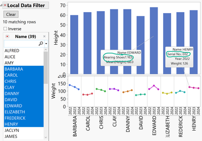

Where I really got in to trouble was that when I hover over the height I want the pop-up to show if they were wearing shoes during the measurement, and when I hover over the weight I want to know the serial number of the scale that was used. When all the data is in one table, and I make Label(1) for both columns you end up with missing values when you hover (because there's no scale serial number on a weight measurement)...which can also be addressed, but it just started to get very messy.
I think the solution of leaving the data in two tables with two synced filters (one hidden) is going to work much better.  But if there's a better way to create this graph I'm open to suggestions.
Just a general shout out to Graph Builder and the ability to control it with JSL.  This seamless melding of two different graphs is only possible because we have the ability to turn off everything on the bottom of the top graph and top of the bottom graph and bring them right up against each other. This has allowed us to create a very customized and very data-dense graphic in our specific situation.  And now we can filter it elegantly too:) Maybe others will find this useful down the road.

Knowing different filtering techniques make it possible to do all sorts of nice things in JMP (sometimes they are also necessary especially if you have lots of data).
I assume that by concatenate you might mean update/join and we could have single table like this (virtual join can be used for this if there is unique identifier)

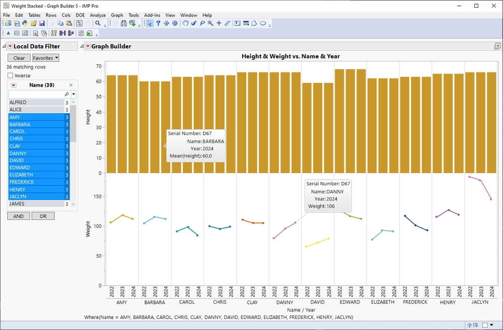

From this it is possible to create a graph like this
You can do it for example by utilizing Textlets (hover label)
Graph Builder(
	Size(1085, 688),
	Show Control Panel(0),
	Show Legend(0),
	Variables(X(:Name), X(:Year, Position(1)), Y(:Height), Y(:Weight), Overlay(:Name)),
	Elements(Position(1, 1), Bar(X(1), X(2), Y, Overlay(0), Legend(13))),
	Elements(Position(1, 2), Line(X(1), X(2), Y, Legend(15)), Points(X(1), X(2), Y, Legend(16))),
	Local Data Filter(
		Add Filter(
			columns(:Name),
			Where(
				:Name == {"AMY", "BARBARA", "CAROL", "CHRIS", "CLAY", "DANNY", "DAVID", "EDWARD", "ELIZABETH", "FREDERICK", "HENRY", "JACLYN"}
			Display(:Name, N Items(15), Find(Set Text("")))
	SendToReport(
		Dispatch({}, "Name", ScaleBox, {Label Row(2, Show Major Grid(1))}),
		Dispatch({}, "Graph Builder", FrameBox, {Set Textlet(Markup("Serial Number: {:Serial No.[local:_firstRow]}"))}),
		Dispatch({}, "Graph Builder", FrameBox(2), {Set Textlet(Markup("Serial Number: {:Serial No.[local:_firstRow]}"))})
You can customize the text shown much more if necessary, Using JMP > JMP Reports > Customize Hover Labels in JMP Graphs > Add Text to Hover Labels in JMP Gr...
-Jarmo
Thanks @TomF - very cool trick to fight against the restriction of label settings: use 2 tables : )
I wonder why it's not possible to generate plots like this - neither in the separate graphs, nor combined in one graph.
setting the label for one graph automatically forces the other graphs to show the labels as well : (
