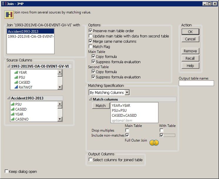

This is a screenshot of the Join dialogue that I have been trying. For the earlier screenshot, I chose YEAR, PSU, CASEID to be output from both original tables by selecting them for the 'Output Columns', which I haven't shown here. I have also done a Match Flag output in the past and it shows that it is getting the data from only one table in lots of cases (flags 1 or 2). It confirms that there is no match happening, but I don't know why it's not finding a match despite the data being in both original tables.

I still want to focus on the values. Your Year column, is it a JMP Date value, formatted to just show the year portion of the date, or is it an integer?
What are the specifics about the CASEID column. It is being displayed as a character column. Is this the case or is it a numeric column being displayed using a Hex format?
If it is character, there can be blanks or unprintable characters in the string that might be causing the mismatches. If you use the match flag, it is fairly easy to check this out when you find the row with the match flag of 1 and compare it to the row from the match flag 2 row that should have matched with it.

The Year column is an integer, not a date.
In looking into your question about CASEID, it appears that it is of data type Character. I see now that sometimes the CASEID has a space before the number. Do you think that is the issue? I'll work on removing the blank spaces to see if this fixes my join issues. Thanks for your help!
