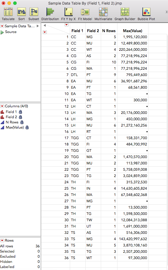

Not sure if this helps but I used Tables>Summary and then used Field 1 and Field 2 as Grouping variable and Max as the statistic.

Thanks for the quick response! My goal is to have an output table with one row per unique entitry from Field 1 with corresponding most frequent Field 2 and Max value... It's essentially a data consolidation problem where I need to filter down to concise dataset with no repeated rows...
Thanks,
Chris
