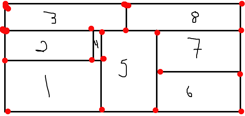

Essentially, I have a "map" that consists of several rectangular regions. I have access to the coordinates of all the vertices of each rectangular region (their x_min, x_max, y_min, y_max).
I randomly generate a point that lies anywhere on that map. I know the coordinates of that point (x and y). The problem I want to solve is to find out in what region the point lies in.
what I have done, is just go through a big condition statement checking through one by one if the x & y coordinate of the point is between the x_min and x_max and y_min and y_max of every region. However, I feel like there has to be a more scalable, generalizable, and efficient way to do this but I cannot find a way to do so, at least not something that isn't in a library for a different programming language. I thought of maybe doing something where I split the map in half, find out which half the point lies in, count up all the regions in that half, check if there is one region left and if not, split the map in half again and go through the process again. I just don't have a good idea of how that can be implemented and whether that is feasible or better that the current method I have.

If I was inventing an algorithm for the tiled rectangular regions, I'd use the KDTable function and load all the corner points into the table. Something like this:
one to four rectangles share each cornerone to four rectangles share each corner
The KDTable will efficiently tell which corner is closest to any queried x-y location. If you keep another table of all the rectangles that share that point, you only need to check up to four. Depending how you order the data, just knowing <x, <y (etc) tells which quadrant, and you might not need to check as much.
The KDTable is pretty much doing what you described, in K dimensions. for x-y data, K==2.

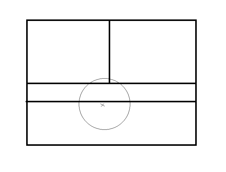

Or maybe it is harder.
This will find the wrong corner.This will find the wrong corner.
