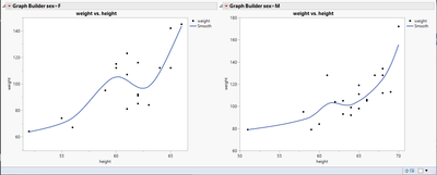

I would like to have separate values (min and max) on the x-axis for F and M (BigClass example), so for example F goes from 60-140 while M goes from 70-160. Is this possible? or could there be some other way around it?

Not sure if you do it with Page, but you could use some scripting for example with By parameter:
New window("",
	Lineup Box(N Col(2),
		Graph Builder(
			Variables(X(:height), Y(:weight)),
			Elements(Points(X, Y, Legend(1)), Smoother(X, Y, Legend(2))),
			By(:sex)
Do note that these are two separate graph builders

Thank you for your fast reply. Yes using "Page" could be a solution, but will it be possible to arrange the graphs horizontally instead of vertically?
New window("",
		Graph Builder(
			By(:sex)
-Jarmo

Thank you very much - this is highly appreciated. Even though they are two separate graphs, it sure does the job!
