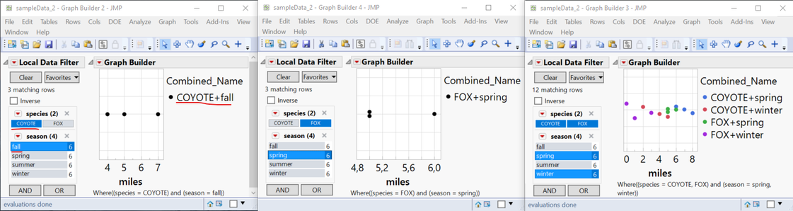

If you create just some plot from your table using Graph Builder and add :species as well as :season to the local data filters, while using the :Combined_Name column in the Overlay field, you will see that the legend is updated with the filter selection. (See screenshot below.)
Based on the above screenshot example, I am therefore wondering what would be the benefit of filling up the formula column (:Combined_Name) with the filter selections made.
