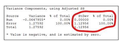

I am trying to find the Between-run standard deviation percent of total standartd deviation on some data in JMP. I have an old example of the output I am looking for from previous data analysis that was completed in minitab (see attached screenshot). How do I get the same type of results in JMP?

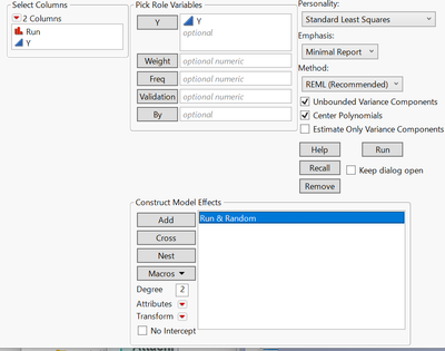

It seems that your model is a variance component model (or a random effect model). You can fit a (one-way) variance component model on JMP by the following steps.

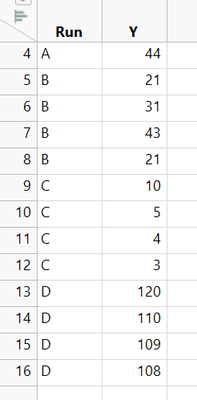

(1) You need to prepare two variables in the input data.
The one is the continuous response variable which contain measurments. The other is the nominal group variable, which is "Run" in the example. Note that you need to set the "Run" column to Nominal.
(2) Select [Analyze] > [Fit Model]. The Fit Model window is launched.
(3) Set the response variable (or the measurment variable) to [Y].
(4) Select "Run" variable, and click [Add] button in the Construct Model Effects panel.
Select the "Run" variable in the Construct Model Effects, and click the red triangle icon for the [Attributes] and select [Random Effect].
(5) Click [Run] button.
(6) Go to the REML Variance Component Estimates table. Rihgt-click somewhere in the table,and select [Columns] > [Sqrt Variance Component]. This shows standard deviations of variance components.

These all get close to what I am looking for but I still cant seem to find the standard deviation percent of total. I can only seem to find either the percentage of the total variation each component accounts for or the standard error of each variance component. I am looking for the standard deviation % of total of the run vs the error.
