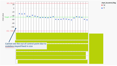

I kindly need help in to create a JSL script that does not make my variability chart scalebox stay fixed in one size because I'm having problems to see any values when the value is outside my control limits. Below is an image how the chart looks like for a given script. Appreciate it if someone could advise me how to let it ensure all the points inside this chart

I believe you will get what you want if you delete the Min(), Max() and Inc() references from the Scale Box definition, and let the platform determine what those settings should be for each run of the code.

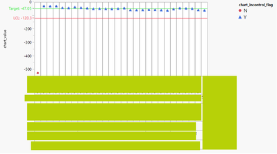

Hi @txnelson. Its nice to have you on board. I did attempted what you advised before posting this. It nearly worked unfortunately after writing the following script, I'm unable to see my Upper Control Limit (UCL).
