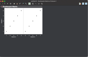

Hi all experts,
A rookie question of scatterplot-matrix: It seems the "chart size" won't be automatically scaled as I drag the "outer" window boundary.
Any way do enable it? (Mac user, have looked up question but didn't get the answer)
Thanks!
Screen Shot 2022-08-29 at 10.04.31 AM.png    ------- outside boundary extended but chart itself isn't-------->   Screen Shot 2022-08-29 at 10.04.42 AM.png

Craige_Hales
Re: How do I enable "fit to window" in scatter-plot matrix
for the graphs that don't stick to the window, resize by dragging the bottom right corner of the graph. If you have not already resized the outer window, the outer window will adjust to the new graph size. GraphBuilder works both ways. The legacy graphs mostly don't stick to the window.
I'm not sure if there is a way to restore the resizing behavior after resizing the window instead of the graph.
