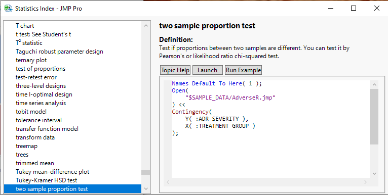

  1. The Two Sample Proportion is available in the Statistics Index under the Help Pull Down Menu2samp1.PNG

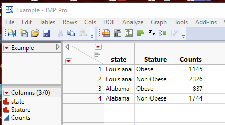

  2. In the example shown, the data table is in the raw form, having all of the individual measurements, rather than the counts being summarized as in your data. So your data needs to be setup like below.  Note there are not any "All Males" cells.  What I assume you really want are Obese and Non Obese cells2samp2.PNG

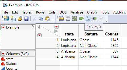

  3. To analyze the data you need to use the Fit Y by X platform, available from the Analyze Pull Down Menu or from the Analysis Icons located just above the data table2samp2b.PNG

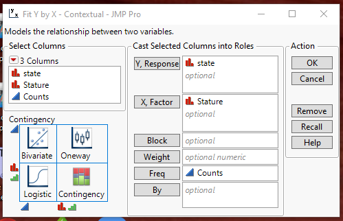

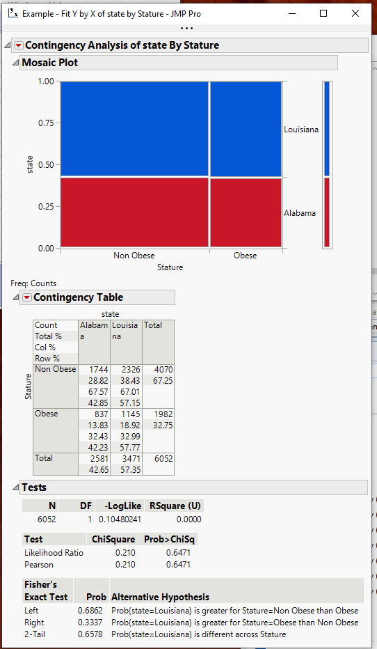

  4. It will open the below dialog window, and then you populate it as shown2samp3.PNG
