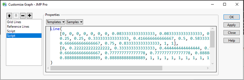

You could create a graph using the following scripts which puts on a new graph the reference line and two ROC curve lines.
The values for the ROC curves are obtained by right clicking on the ROC curve graph you obtained in the analysis window and choosing "customize", then in the script window you get the script of the line. You could copy those and paste them in the script below replacing the lines that are currently their. repeat this for every ROC curv you want to add.
Hope this helps.
