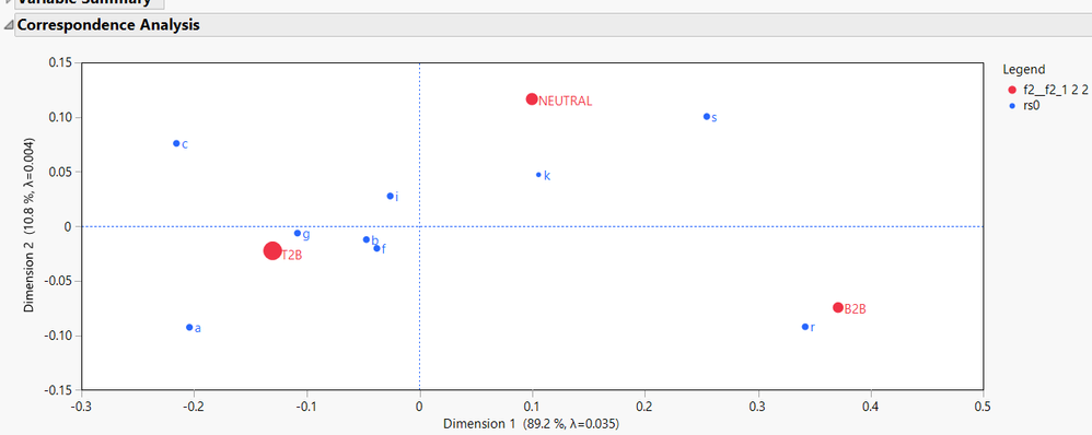

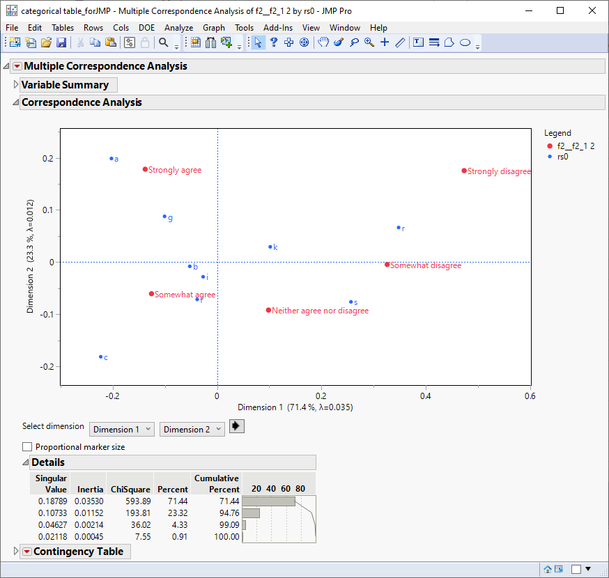

I find Multiple Correspondence Analysis to be very helpful in cases with many categorical levels. Here is a simple example using your data to illustrate the basic approach:

I think this would work for me.  Would you please check my thought process?
I could start showing the MCA plot to illustrate the importance to question f2f2122 of B2B response and location r.
I reinforce the statement by graphically showing the partial inertia contribution of B2B and location r to Dimension 1&2.
I might be asked for a threshold statistic (like a Cochran's Q?) to determine next action, but I can say we can align on which questions to potentially throw out after looking at results of 90 questions.
Does this make sense?

I've used MCA before and I know how to assign roles.  My last question has to do with my customers asking what to do with the results;  a hard-fast statistic like a threshold value (say, UCL in Hotelling's T2 in outlier analysis) would make them happy.  In MCA, whilst I have inertia and partial contributions, there's no such threshold I can pinpoint.  But that's ok.  I was looking for something more along the lines of qualitative analysis, and I got it.
Thanks to your suggestion, I now have another use application for MCA!
