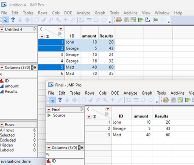

txnelson
Re: How do I create a new table avoiding duplicates.
Here is a little script that seems to do what you want
Names Default To Here( 1 );
dt = Current Data Table();
dt << select where( :amount == Col Min( :amount, :id ) );
dtFinal = dt << subset(
	selected rows( 1 ),
	selected columns( 0 ),
	output table( "Final" )
Jim
