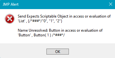

And I can select one or multiple options. But I end up with these two errors:
  • Send Expects Scriptable Object in access or evaluation of 'List' , {/*###*/"0", "1", "2"}
  • Name Unresolved: Button in access or evaluation of 'Button' , Button( 1 ) /*###*/
Which suggest that I am not handling the buttons correctly in the SelectNumericValues function and that I am also incorrectly dealing with the returned values in the Select Where function.
