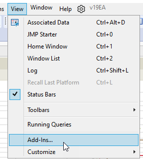

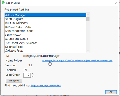

For the AddIns just go to the AddIns Folder and copy all subfolder to the new computer:
