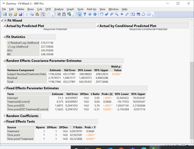

results seems to me similar for both i.e. Mixed models with Residual covariance structure as instance vs. REML method
as highlighted below
The mixed model will help you select the most appropriate covariance structure based on AICc.
