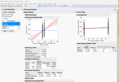

How do I analyse data for DoE study with a categorical factorial?
In DoE study with a 3-level categorical factorial, can you exclude and hide data for one category and analyze the data for other categories?
2 REPLIES 2
txnelson
Re: How do I analyse data for DoE study with a categorical factorial?
You can use a Local Data filter on the Results Display and select the factors you want to keep in the analysis.
I will not comment on the wisdom of doing such
Jim
Why do you want to exclude data?
