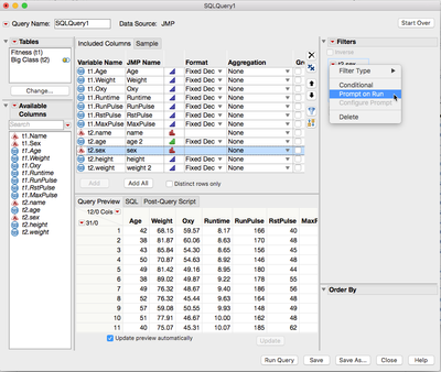

Jeff_Perkinson
Re: How do I add prompt boxes for parameters when writing custom SQL expressions
If you use the Query Builder it will build the prompts for you automatically using the "Prompt on Run" option in the filters area.
When you run the query the user will be prompted. No reason to build it yourself.
-Jeff
Yes. when I build the queries directly in JMP, I can get the prompts. My problem I have is when I take an existing query and put into the custom sql query, my prompts aren't available. For a simple query, the query builder in JMP works, but I have some fairly lengthy and complicated joins that I'm trying to not have to rebuild.
