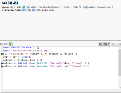

The script you attached adds 5 reference lines.  They will be placed at x values of 1, 2, 3, 4, 5. If you want them placed in different locations, you will need to update the script with the appropriate locations.
Please look at the Add Ref Line entry in the OSI to see how the syntax works for reference lines.

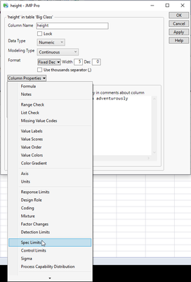

Hi @BrandonP1092 ,
  In addition to what @tonya_mauldin has suggested, you might also consider adding either Spec Limits or Control Limits as meta data to your columns. Right click your column and select Column Info. From the Column Properties pulldown menu, select the one which is appropriate for your needs.
After you enter the spec/control limits, you can select "Show as Graph Reference Lines", and each time you make a graph, distribution, etc with the data, it will have thin blue line(s) for the USL, LSL, and target (if not missing).
If you are more advanced and do a lot of scripting, you can automate this process using the Analyze > Quality and Process > Manage Spec Limits platform. It makes your life a lot easier if you have to do this a lot.
