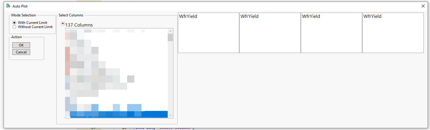

How could I build display boxes in modal window basing on radiobox selection
My code is like below, it works well if I click option 1 and 2 one by one, but multiple list box would be generated after I continuously click the option 1 which would make my users confused. How could I optimize the code? Many thanks.

I mean that how to use radio box to generate display boxes, like when click option 1 is to generate a list box A, option 2 is to generate a list box B, option 3 do nothing. What's more, if I click option 1 and then click option 2, the list box A would be deleted and a new list box B would show up.
In my code, all things work well  if I click  option 1 --> option 2 --> option 1 --> option 2.... but if I click option1 multipe times, multiple list boxes would show up, this would make my user confused, below is the image shows that 4 list boxes are generated after I click 'option 1' 4 times.

Re: How could I build display boxes in modal window basing on radiobox selection
When I click option "With Current Limit",a new list box would show up at the right of panel "Select Columns", if I click option “Without Current Limit”, the list box would be deleted,  if I click option 1 --> option 2 --> option 1 --> option 2, it works well. But if I click option1 multipe times, multiple list boxes would show up, this would make my user confused, below is the image shows that 4 list boxes are generated after I click 'option 1' 4 times.
Sorry for making you confused. The problem I met is not related to certain table but a UI development question.

Atong
Level II
Thanks, your code works well in non-modal mode.
In modal mode, if I click option 1 --> option 2 -- > option 1, the list box will not show up, but when I tried additional option 2 --> option 1, it shows up! Basing on my investigation, I found seems there is a non visible List Box behind panel colSelLstBox, I can't call it and detele it, but after option 2 is operated 2 times, it will be finally deleted, so option 1 can work. So interesting....
My final solution in modal mode is to add a size(0,0) spacer box then I can get the handler of it, judge if it exist, delete or generate.
