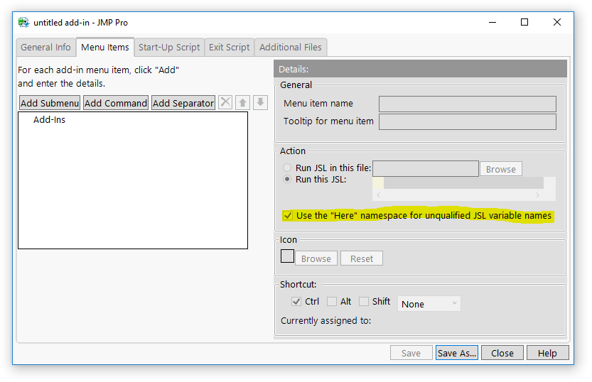

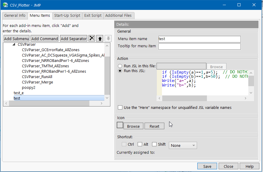

ANSWER ==> Un click the "Use the "Here" namespace for unqualified JSL variable names
It works for standard add-in script and for encrypted scripts.
Un select:  Use the "Here" namespaceUn select: Use the "Here" namespace

Jeff, thanks for the confirmation. Yes, I agree. It's a scoping issue. However, the solution is to uncheck that box in the add-in. This allows the outside script to set a global, and the internal add-in to use it. I wish I could have found that in one of the guides. Oh well.

I think this will get you close to the answer; it looks like the default is to use the Here namespace in an addin, so you might need to use global:a rather than a
checked by defaultchecked by default
